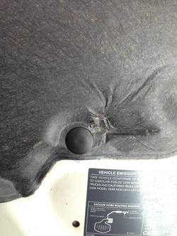

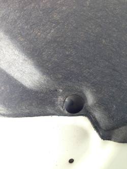

After all this time troubleshooting a creaking sound involving the front end of my FX when I'm turning, it turns out that my brace is contacting the hood as well. This is such a bummer. The hood sits where it is supposed to when closed, so it's not as bad as other members' situations and I ruled the hood contact out, but it does in fact contact the hood; when I'm turning over bumps, it is pushing the hood up and causing the creak. Can you help me with this? Here is a photo of each side where the bar has been contacting the pad on the underside of the hood:
That looks all to familiar. I would guess that eventually your hood will be damaged in some way. I sold mine on the forum a few months ago and offered a fit guarantee to the buyer. He says it fit right out of the box. I tried several bars and brackets and no luck. GTSPEC test fitted something like 35 bars on an FX before sending me the last one. They offered me my money back at that time but I was pretty busy and decided to sell it cheap on here to someone else. I took a loss but helped out a fellow member after all said and done.
Hey Brennan, I think I might be having the same thing, what was the sound that you were getting?
I'm getting something that sounds almost like a creaking door kind of sound when I go over uneven terrain at low speeds.
Same sound! That's probably what's happening to you then, too. Check the pad under your hood for dent marks. It's especially obnoxious for me because my closer parking spot at my condo has a speed bump right next to it. So I have the cold start issue (gotta crank twice) and then when it's finally on, I back over the speed bump to the sound of a haunted house door.

The good thing is that the bar is hitting a portion of metal in the hood that is pushed away from the actual outer layer of metal on the hood, so when you close the hood, it won't dent the outside. But still, not good.
