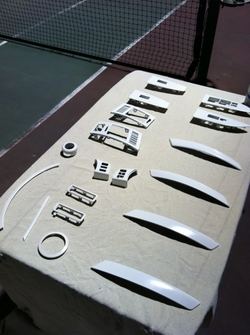

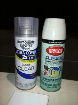

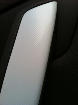

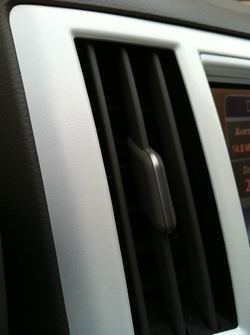

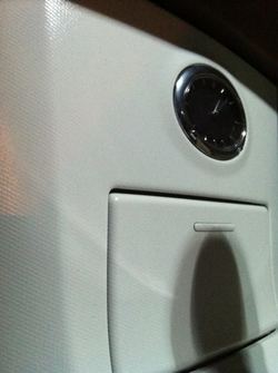

Painted my interior trim pieces with Dover White Krylon spraypaint (4 coats) and clear coated with Rustoleum clear gloss (2/3 coats, depending on part). Super stoked with the results! Matches pretty much perfectly to the Ivory Pearl (without the pearl obviously). Here are some pics:

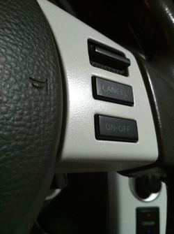

Did you remove the steering wheel at all to take off the decorative aluminum peices?
I did not remove the steering wheel, just pulled the pieces toward me away from the steering wheel. BUT, there are tiny yellow pins under the buttons, so if you do this, be careful. I lost three pins inside the steering wheel and spent an hour fishing them out -___-

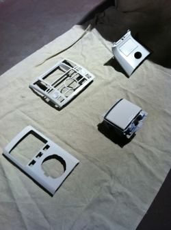

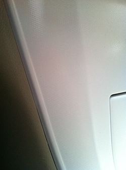

A couple people have asked me to post detailed pics of the painting. Here are a few:
