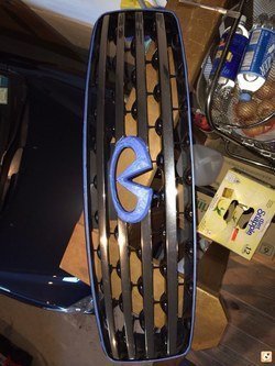

I just finished taping up the emblem and border. I'm about to plasti-dip now.a7y7y7uh.jpg

I just finished my first coat of plasti. It looks weird. Gotta wait 30 before I can keep going though apparently 3uqe4uma.jpg

Thats the first coat? I think u went way too heavy on it, first coats supposed to be light with 50 percent transparency bro either that or it looks like you maybe didnt prep the grille correctly bc it looks like its bubbling and not bonding.
Sent from my SAMSUNG-SGH-I337
Uhm, that looks very heavy for the first coat. The first 2 coats should not cover the grille entirely. You might be spraying too close too heavy?
The bubbles look worry some. You don't want to create fish eyes.
Yeah I didn't realize how cold it was today. I think the plasti-dip was still kinda frozen. I have to re-do it tomorrow in a warmer garage instead of outside. I will use it as a learning experience haha.
