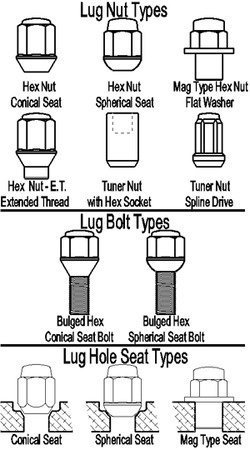

So for FX50's OEM wheels, you don't use cone seat lugs? Interesting I never heard this brought up from people who bought OEM 21's.
I like cone seat, it feels like it centers better than a pure flat seat.
not particular only on FX50 wheels , but even gen2 18's or new G or M wheels. It's a mixed bag at this point, need to look inside before one can judge if it's acorn or shanked.

Btw test fitted the lugs, actually impressed with mag seat vs cone seat. Seems like much more stud engagement and secure.
