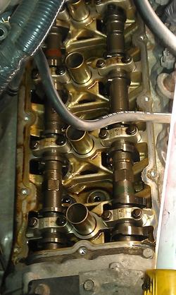

Thanks. But spoke too soon. Pretty embarrassed, but here is what 140,000 miles in Chicago does to your engine bay and what failed o-rings on valve covers does:
190 AMP alternator hasn't arrived yet, but water pump, new belts, new valve covers, new spark plugs, new gaskets, new coolant hoses, new FX35 electric fan, wiring for Dakota electric fan controller (will be inside car, exposed circuit board -- sorry Lance, don't feel comfortable leaving it in the engine bay even if you have no problems) to list a few all in the works.

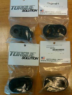

Polyurethane 15mm exhaust hangers (anyone else should be using 9 or 12 mm):

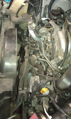

Surgery, guess the mod:
Go Ed Go! Hey, what the hell is on your radiator, is that cow dung? Where do you drive?

BTW, that is a perfect picture of the pick-up install and will be very helpful to fan modders.....
