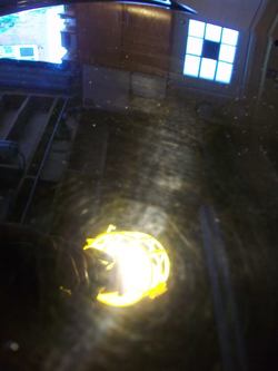

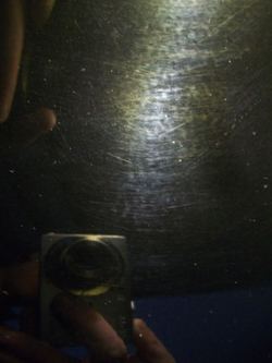

Before shots of the neglected G35:
top of trunk swirls
right quarter panel, behind the quarter glass
right side of the hood

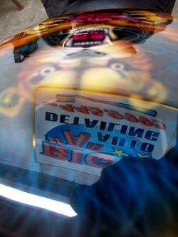

after shots:
drivers door
hood

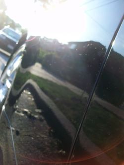

So you want to see the car under direct sunlight? Here you go:
trunk & wing
right quarter panel
right door
right fender

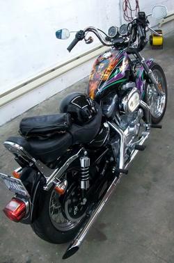

BIG "A" DETAILING 02 Harley Davidson 1200 Sportster Detail
Three Different metal polishes were used to bring back the dullness of the parts after the customer washed the bike with 409 Degreaser!
There was some light over spray on the chrome exhaust pipes & paint from the new paint job that was recently just done.
I clayed the tank & fenders twice,
applied some Optimum compound & polish by hand
then applied three coats of RejeX sealant to all paint work ( by hand),
allowing each coat to cure for 15 mins
I started with the Wizzards first.
Wizzards in action
We'll get back to the metal polishing later.
Before
After
---------- Post added at 01:31 PM ---------- Previous post was at 01:30 PM ----------
Removed a screw & lifted the seat
Side of the tank - finished
Top of the tank - finished
Some full shots of the bike - finished
