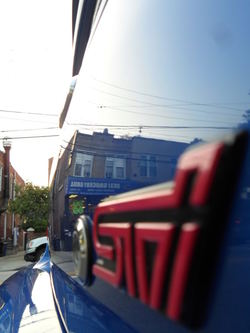

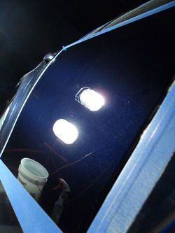

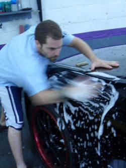

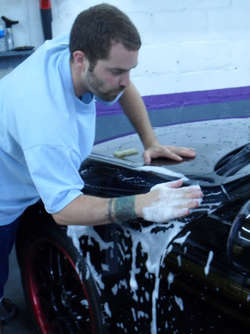

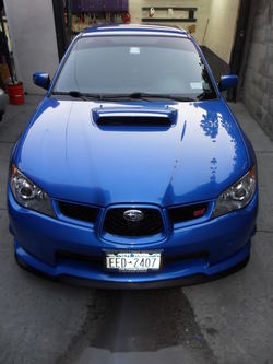

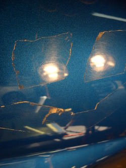

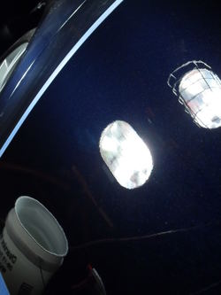

a few weeks ago Jeurry came back for a nice hand wash, clay & hand wax.
we applied some Collinite 915 Marque De Elegance Carnauba Paste Wax.
its been about 2 months since we did a full wetsanding of the nose & a complete clear coat correction. the car is still looking sharp with no swirl marks at all.
i promised him the free hand wax after taking a little more time than i told him when he dropped the car off. like always, i try my best to make every customer here leave happy with theyre car.

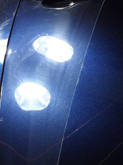

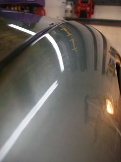

2002 CLK from Deleware.
this customer now holds the title for longest distance traveled to my shop in Queens, NY for a detail. he lives a little past Philly, about 3 hours away without traffic. he drove up for the detail & left the car with me. i first thought a week would be enough time but it wound up being a 2 week job. the customer wanted the swirls out & was very patient with me. he told me to take my time & thats what i did.
this car was really bad. whatever before shots of swirls that i took, that's exactly how every square inch of the paint job looked. extremely dull, tons of deep swirls & lets not forget about a rock hard clear coat. cars with hard clear coats take longer to work on because the swirls & scratches take longer to remove. for cars with softer clear coats it should take a lot less time to do a job like this.
the list of what was done:
1View attachment 182506
after a long drive up from Deleware this is how the CLK came into the shop.
the customer confessed that its been about 4-6 months since the last wash.
---------- Post added at 03:55 PM ---------- Previous post was at 03:55 PM ----------
lets start off with the roof
---------- Post added at 03:56 PM ---------- Previous post was at 03:55 PM ----------
hood before
hood 50/50
look at all those stone chips. this car has about 127,000 miles on the clock.
---------- Post added at 03:56 PM ---------- Previous post was at 03:56 PM ----------

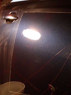

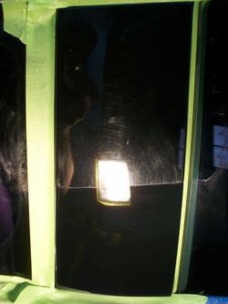

drivers door 50/50
above the drivers side rear quarter glass 50/50
above drivers door glass 50/50
trunk50/50
---------- Post added at 03:57 PM ---------- Previous post was at 03:56 PM ----------

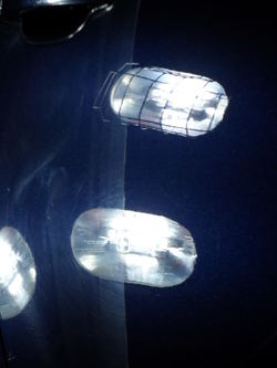

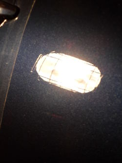

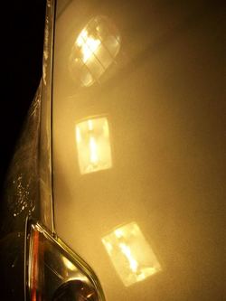

after compound & polish
after- with the lights off

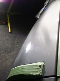

passenger quarter panel 50/50
gas cap
top of the passener quarter panel before
after
---------- Post added at 03:57 PM ---------- Previous post was at 03:57 PM ----------
after passenger quarter panel- with the lights off
using the lader as a tripod. that's where your supposed to place the can of paint.
trunk
rear bumper
---------- Post added at 03:58 PM ---------- Previous post was at 03:57 PM ----------
SOME FINAL SHOTS TAKEN BEFORE THE DRIVE BACK HOME TO DELEWARE
hood
roof
trunk
from the back
from the front

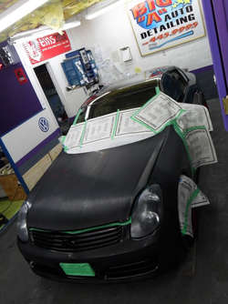

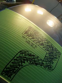

G35: wetsanding the nose 17 pics
NICKSG 03 Black Infiniti G35
wet sand entire nose
remove light to medium over spray on the whole car & glass
rotary machine compound & polish under halogen light for as close to perfect that i can correct the finish!

this pic will introduce all of the readers to Nicks 2003 Black Infiniti G35 sedan.
The Best Of James Taylor CD is playing in the background.
Fire & Rain is on & my mind is at peace. its hot but i have much work still to do on Nicks G. hes still in Jamaica & hasnt returned my pms that contained the progress on his car. i guess he just wants to be surprised instead of being teased like everyone else lol.

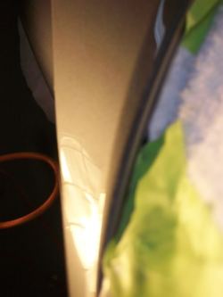

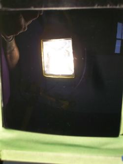

03 350Z Heavy Clear Coat Correction + wetsanding 134 pix
this detail was from a few months back.
2003 Gold 350Z Heavy Clear Coat Correction with some extra surprises
heres a few pics of the car after 3 washes, 3 times clay barring & all prep tapping finished. this car is ready to be sectioned off for a handfull of 50/50 shots. ill try to let the pics do the talking to save some time typing every little step up. the pics will take you from start to finish. i hope you all enjoy reading the writeup. this will be a big one!
i try to concentrate on the big jobs that require a lot of heavy machine work since neither of my 2 guys know how to buff & i dont plan to teach them either. my job is to book them as much work as they can handle to keep the shop as busy as possible. they do help me a lot on these big correction jobs. i have them do the prepping & i work side by side with one of them so this way theres 2 sets of eyes checking each panel as im buffing. ill have him follow a few panels behind me with a damp microfiber towel as he inspects the paint a second time under the halogen light after ive already done so. as the panel is being double checked, im already working out the swirls & other defects on the next panel ahead.
we go around the car once during rotary machine compound then do it again for the rotary machine polishing steps.
after were done polishing the car well remove all masking tape & hose the car off to loosen any dust from the compounding & polishing. then the car gets brought back inside & wiped down with an absorber to remove about 85% of the water. a leaf blower is then walked around the car & the water drips are collected with another absorber towel. me & my guy will go over the car one more time with the halogen light, one holds the small 700 watt unit in his hand while the other guy is looking into the paint to see if weve removed all of the defects 100% or not. if there are still some swirls & scratches left over ill tape the car again & give the car one last round of machine polishing till each panel is completely glassed out to perfection & ready for a coat of sealant then wax.
i wasn't going to put together a writeup but this one has a few surprises. the hood has been resprayed by a body shop. on the passenger half the clear coat seems to have faded a bit. i hope i can pull everything out without going past the clear coat & burning right through. im going to try to save the hood by wetsanding it with 2000 grit. to make the sandpaper soft ill rub 2 pieces of 2000 grit together then soak them in a cold bucket of water with a few drops of soap for lubrication between the paper & the clear coat. if i can save this hood ill save the customer a lot of money that he wouldve spent on the respray. at first i didnt want to wetsand the hood but the customer agreed if i burnt through i wouldnt have to pay for the respray. i over heard his friend who owns a body shop say something like "i dont think he can do it or hes scared to do it but it can be wetsanded". i cant stand when someone doubts me. i didnt want to risk it just in case i did burn through i wouldve ended up doing this entire detail for free then laying out the $ to fix the hood with a respray. thanks to the customers friend he will cover repainting the hood if i should burn through. well see what happens. this should be a fun one!!

06 STI Halogen Light Correction 62 pics

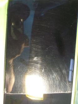

the car had spent the previous week in the shop getting a few things fixed under the hood. it went straight to me afterwords & i had it since Monday (6 days). the customer was dying to drive the car. 2 weeks without his Suby was heartbreaking lol! it was sat afternoon & it was finally ready for him.
when Josue came into the shop tonight it was about 630 pm & it was still light out. i watched him walk over to the car & suddenly his face was glowing with a really big smile. he was deffinitly impressed with the work. im pretty sure i went beyond what his expectations were for what the car would look like after i was done with the detail.
it was difficult to find the time to take the pics but i found a way.
i selected the hood, passenger fender & front passenger door because they were right next to eachother.
i tried to get as many after shots as i could.

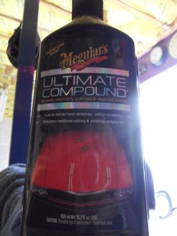

view all of the pics & you will see what products were used.
shout out to LISC.
thanks for the support through the years.
www.longislandsubaruclub.com
orange pads for the compound

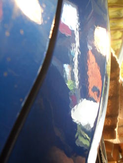

bottom of pas fender.
thats the rough texture paint thats on the rocker panels & the first 2" or so of the fender & doors as well.
a little bit above the rough textured paint

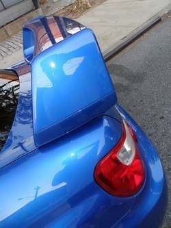

finished photographs: it was cloudy out =/
Josue distracted by the muscle car. i bet at this point he cant wait till im done taking some pics so he can beat the crap out of his Suby. after 2 weeks of not driving here he was really looking forward to the parkway ride back home =)

E60 Correction+Acid Water Stains 66 pix
the clear was tricky to work with. i would say i got the acid water stains removed about 95%, not perfect like im used to doing. i was a little upset about that. the car came out really good anyways.
the customer was really happy so that was a good thing. he luved the job i did for his 5 series BMW.
when i put a car under the halogen lights i aim for 98-100%.
95% probably bothered me more than the it bothered the customer lol.
the acid water stains were really hard & deep. they were in there. it looked like the car was left outside without any wax & then got rained on. perhaps the car had been sitting around not being driven for a few months?

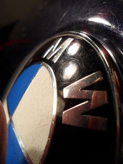

Rondel Correction.
i thought this would be fun =0)
it had those crackling like defects before i put the machine to it.
the swirls were annoying the crap out of me.
i think that is much better now!

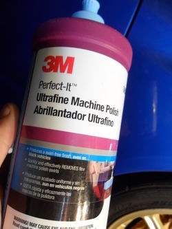

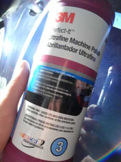

back to my roots with the good old stuff. theres only one reason why this product is still in production after all of these years. because it works! the dust isnt too bad. when it dusts, the dust doesn't cake up like what other detailers say about Meguiars M105 Ultra Cut Compound. this is still a great compound for when you need a little more of an aggressive bite to the paint!
ive tried a bunch of different brands but my luv for 3M has grown larger today than it ever was.
i love you 3M Compounds & Polishes, youve made me lots of money through the years.
thanks.
@ 1,500 rpms
ive been using this forever as well. great product, great working time. it really lets you spend time on the panel, as long as you keep the pad moist with one spritz of water. it takes longer to dry out before you need to wipe off & apply some new product for another round of polishing. longer to dry out then say Meguiars M205 Ultra Finishing Polish which seems to dry up fast. it makes you curse at Meguiars because you know the product works really well but you hate working with it because of how messy it can get.
@1,200 rpms
a couple of really deep scratches still remain. my finger nail got cought pretty deep in them.
they were reduced a lot but not removed 100%. wetsanding would not have removed them fully.
