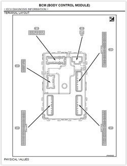

Does anyone know the driver and passenger signal indicator wires for a 2013 FX?

I think I found the answer from the 2012 FX service manual:
Top left connector M119:
Wire #17 color W (white) and #18 BG (brown something??).
So, they should be these:
I guess what confused me originally was the orange wire wasn't actually orange but brown color.
