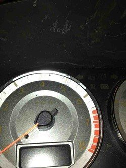

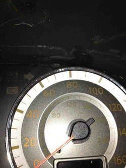

I just plugged the new cluster in,did the 12V Acc wire, and ran in to some problems:
-The gauges will not work(tachometer,speed, fuel, temp), lights up
-shows 999999 miles on the odometer
-couldn't adjust brightness via buttons on the left
-FUEL Icon is on for some reason
Here is a picture:
I don't have active cruise and the new cluster should fit I think(PART NUMBER: 24820-8Y70C)
Please help!:cry:

I've never seen an issue like this, it should just work, only needed aditional wire is for the backlight only... have you tried your old one again? if you swap to the old one and it works fine then the only thing it can be is the new cluster is bad
what many don't realize is that the majority of the parts like this that make it to ebay are really from waranty replacements... I've bought several of these already and each one has had some issue, mostly the issue is with the fuel gauge, one didn't work at all and the other was spotty at best, I did get one that the gauge was at least decent and usable too but buying something like this is a gamble as to what will be wrong and how bad it will be...
^ I'll try to put everything back and let you know. Thanks for the quick reply
---------- Post added at 06:17 PM ---------- Previous post was at 05:22 PM ----------
UPDATE!!!
Plugged the old back, works perfect. The new one definitely defective.
Wow, sorry to hear that you got a defective one. I must got lucky with mine. I have been running it over a year now. Andrew's cluster on his FX35 was running good too. Ed's had some speedometer issue with his.
Wow, 999999 miles, lol sorry. You will not be able to dim the dials when the lights are off. They will stay on full brightness. You can only dim them when the headlights are on. It's the same on my '07, during the day with headlights off, the dials are full brightness. Andrew and I have been lucky. My cluster worked perfectly too. It's a shame I didn't swap it when I sold my car....hope you get the right one soon Zebra. The cluster is a great upgrade and looks fantastic!

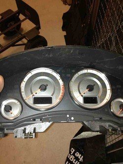

I have a cluster for you but it has a small chrome peel on one of the rings. You can probably touch it up $40 after you confirm it works etc.

Chris, is there some black translucent overlay that's removable on the cluster? I'm thinking of blacking out the tire pressure warning light on my cluster. Since you have one open can you check and see what's a good what to do it?
Not Sure, will check when I get home.
