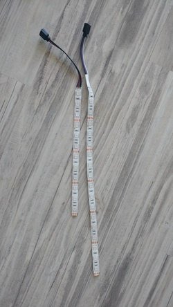

I really wanted to put some demon eyes, but come up with a different way to do that. I used 2 led strips glued around the projector lenses and 2 inside the shrouds

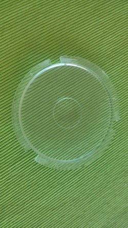

Ordered the FXR lenses and did the cutoff mode. I also had spare lenses and decided to retrofit them where the turn signal is
