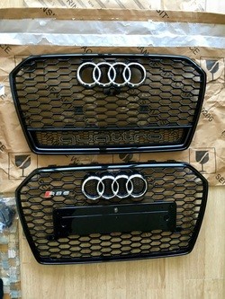

OEM RS grille from Alex@Europrice, top is OEM, bottom is knock off that came with my bumper. When you compare the 2 in hand the difference is fairly noticeable, the price difference is incredibly different so value is up to the buyer.

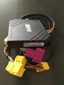

Cete active suspension module.

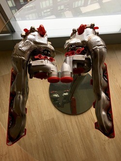

RS turbos from Alex@Europrice

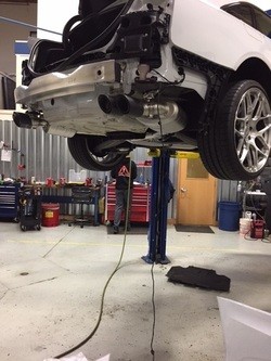

Ran into some very tight clearances with the AMS catted downpipes. Clearance to the back of the engine bay was very tight, Achtuning was concerned about vibrations and other issues. Asked how I wanted to proceed.
Switched gears to the APR downpipes.
AMS coolant tank had to be modified to clear the back of the ACC housing.

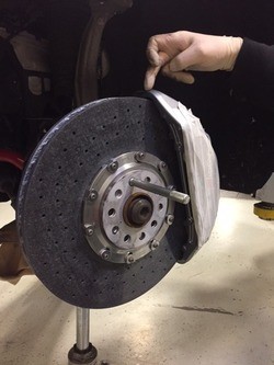

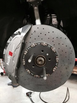

400mm front, notice how close the brake pad is to the disc hat.
Difference between 400mm and 420mm front is visible here.
400/370 kit to maintain flexibility in tire selection.

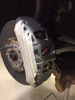

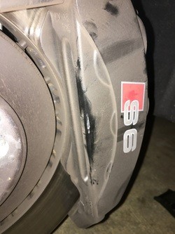

Test fit before paint - Front

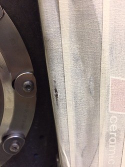

About the same impact spot as the original calipers so still need to run a spacer until I get new wheels
Rear
The front calipers have an interesting profile.

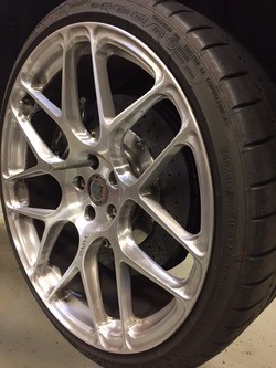

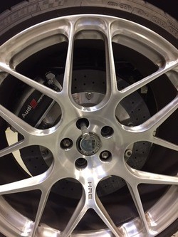

Found a set of the newer HRE caps, if anyone has had HREs before the older flat caps spin. HRE logo should be straight with the valve at 6 o'clock, I'm OCD enough to always want it that way and have the wheel lock at 12 o'clock
Black cars in the dark hide the massive wheel gap. 21x9.5" HRE P101, +22 and +27 offsets, Brushed tint. Wanted to get some lip protection and better than 6 sized side wall so running 285/30-21 Michelin PSS. Them dam side markers in the bumpers are ugly, most regions outside of North America don't even have the openings front and rear for those lights.
