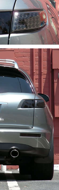

hey guys, sorry to revive my own old thread, but i have a new idea for my tails. I want to do the same thing dr2k did with the blue and what gto did with his, i want to paint my tails with a clean/black mixture to get them tinted. not too dark, but not totally clear. do either of you guys want to chime in with the mixture amount or recomendations ro somethning of the sort? thanks!
We just told the shop to paint a medium center, & a light on the tails. It was a guess, but I think it worked out well. I wanted the LED holes on the sides to be visible, therefore not too dark. Then we masked the side reflectors & hit those again to get to med/dark.
I love how Docs look on DG also. I believe his are tints . . . . Doc?

Laquer based tint. John would likely know the answer to that one. It was painted out of a gun.

just need to tint a clearcoat, wetsand the clear lenses then clear them with the tinted clear. stuff like vht is just too dark & by the time you get even coverage there too dark. if you tint a clearcoat very lightly you can get an even finish not too dark & with the glossy clear it'll look hot, like those^^^
ya i understand that you need to tint a clear, but is this something that is easy, or does a bodyshop/paint shop have to do it? it just seems like if you put black in clear it would turn straight black haha.
your biggest problem will be how are you spraying it? if you put just like 5% black in a clearcoat it'll be a pretty light tint, then several light coats to get the coverage you want. always do a test piece first & try not to get full coverage in too few coats, while trying not to need to many coats to make it as dark as you need it... always do a test piece, could even be a piece of plexi, then you can see what one coat, 2 coats, 3 coats etc really look like...
just wondering, what would you charge for something like this? that's the method i read about online, with the whole test it first, then see how many coats you need. hopefully JB will come back to find all the info he needs.
Ya, just like John is saying. Go one pass or two at a time you're you're spraying to get the desired tint. If you look close, you can actually see the spray (dots) that make up the overall coverage (opacity).
Kinda mist it on
hard to say, not something I normally do. depends how much playing is involved, also weather same shade all over or more elaborate like daves... I'd say expect anywhere from $75-$150 or so for the set
hey thanks for all the answers; thanks for ths pics. i think i want to do somewhere near the medium like gto has on his reverse light, because it looks alot nicwe than straight black like vht. :tongue: yay
