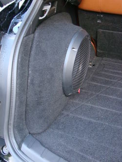

Here's my 10" MTX 9500 in a ported box. The thing takes up half of my useable trunk space lol.

Hey I have the same EXACT sub! Don't you love it! Pounds so strong and very responsive! I really like MTX subs.
Yeah JD the sub is a definate BEAST and can hang with the W7. Mine is underpowered, as I'm using an old Sony Xplod that I had lying around. I really do need to upgrade very soon to hear its' full potential.
You have a knarly setup! Probably the best subwoofer integration I've seen in an FX to date. If only I were handy with fiberglassing and whatnot... but I would more than likely mess it up really badly ha. It took me an hour just to wire the damn thing I couldnt imagine cutting and hacking away. I think that you should start making them and selling those boxes to the InfintiScene family. I would be your first customer for sure!

Thanks. Nope a shop did it for me. I had certain strict requirements and it all worked out. I had strict requirements on the amp and capacitor to also be removable and not take any space. I can remove the sub and amp/cap in less than a minute, but you pay for that kind of setup. Our 400 RMS 10'' MTX sub needs a certain amount of volume for air and luckily with the rear seats reclined they were able to get that minimum requirements, otherwise I would have lost the ability to be able to pull down the rear driver seats from the trunk space. Check out my thread for pics of the amp...I have a alpine 600rms amp and it's awesome....lots of power. It's LOUD bass and it's at like 30% I think because the rest of the stereo can't keep up then.
By the way, the picture above is actually old. In the above picture you can see a crease on top of the box where they glued that carpet on the box. This is how Ian and Andy and them saw it too. I later asked them to redo that part so now it actually looks 100% better. You can't even tell it's more than one piece of that carpet glued on the box.
