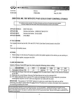

ITB08048
  • IF YOU CONFIRM: If an Applied Vehicle has the MIL 'ON' with DTC P1421 (Cold Start Control) stored in the ECM and There are no drivability issues, ACTIONS: 1. Refer to Step 2 in the Service Procedure to confirm this bulletin applies to the vehicle you are working on. 2. If this bulletin applies, reprogram the ECM. See this bulletin for further detail.
This issue is specifically ONLY FOR THE FX50
ITB08048
Where can I find this TSB in full?
