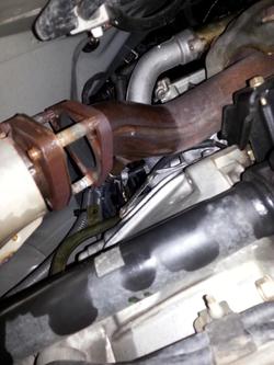

Some progress so far, A one man job so its coming along slowly.

Wow bro you have talent. The takes a lot of balls to do yourself.
Word of advice, since you have the engine apart like i would just replace the valve cover gaskets while your at it. Common problem on the DE motors where the gaskets leak oil into the spa plug cylinders.kr
Valve gasket check, solid dried so I'll keep it in until it start took leak, It appear to be good shape, its getting cold so I'll only replace whats needed until
the summer. complete service will done when it get warmer, for now just coolant flush, trans and oil replace to get rid of old one that have been sit in the engine.
Impressive man, as stated above you have huge balls and talent to be doing this yourself. I consider myself very mechanically inclined and savvy yet would never even think to attempt this.
Good progress though, get in contact with me once you get her back up and running I still have those headlights for you...
Thanks, I'll post first start up video. keep my fingers cross and hope it start. deffinately will do headlight after its up and running again.
Nice work! Cool that you're doing it on your own. I had to replace the VQ30 in my old car and it was scary. And I was lucky enough to do it at a friend's shop so I had access to a lift and all that. Don't know if I would have done it in my garage. Most nervous moment was when I was about to first fire up new motor. Luckily it started right away. Was leaking coolant like crazy and had several vacuum leaks, but tighten some hoses and good to go. So is it up and running yet?
Very nice work, reminds me when I did an engine swap in my Turbo Supra a few years back, gotta have patience and you mark things and group parts in boxes or bins. If you don't have a photographic memory, take photos, cheaper than losing hours on reading the service manual or trial and error. Great work!! Let us know how it went!
Nice work.. I replaced a engine on a Hyundai a few months ago.. Was fairly easy except for the headaches when lifting the motor.. The trans was stuck so had to pull both out...
If i were you, i would replace everything you can while you're there.. that way you won't have to worry about anything later on.
