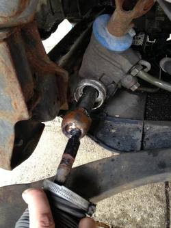

Remove the rubber boot and pull it back so you get access on the square piece to fit a spanner on it to loosen it.
There should be some special tool to get a hold on it but i used a big adjustable wrench and got a good hold on the square part and "hammered" with my hand on the wrench and it came loose.
On the gear shaft behind it there is another flattened piece to fit a spanner, this should be used to prevent putting all the torque on the gear linkage inside.
Luckily mine was not that tight and came loose quite easy so i was not afraid of damaging something but i must recommend you that when you notice it's very tight to make sure to use a backup wrench on the gear linkage to prevent damaging it.
On this picture you can see what is inside the rubber boot, also here you can see the damage on my inner tie rod.

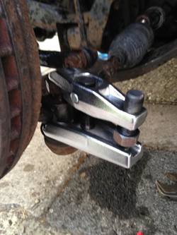

Next thing up is to loosen the outer tie rod, for this job a ball joint press is a must to be used.
Remove the split pin and loosen the nut, do not remove it yet as you want it there to keep the rod a bit in place when it comes off.
They do come off with quite some force so be prepared for it.
Adjust the ball joint press till it makes a good fitment with the tensioner rod fully retracted and slowly start putting tension on it.
When you are going to reuse the outer tie rods make sure the rubber protection boot is not between the ball joint press as this will damage it and allows dust/sand and water to enter the balljoint which will wear it out very fast.

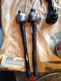

Here a pic of the old and new inner tie rod, you can see it's bend on the threaded end and also on the other side where the ball joint sits its bent completely.
As for me, i simply did the same amount of turns on the new tie rods so it should be around the same as the old one.

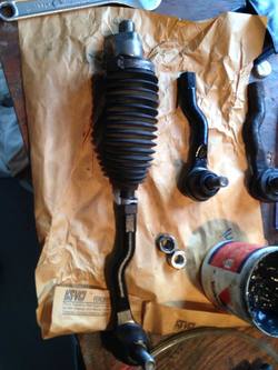

When putting the inner and outer tie rod together make sure all parts are back on such as the rubber boot, clamp and locking nut otherwise you have to remove the outer tie rod again later on.
New one ready to go:

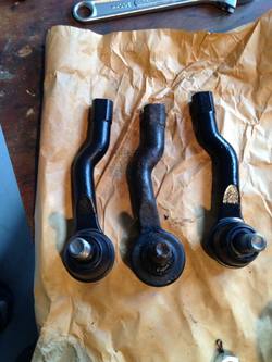

If you do the same as me and change out the outer rods as well, make sure you install the correct one on each side as the left and right version are different.
See picture,
