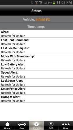

1. Depending on how new the Viper system is that they installed in your car, you may or may not have to press the start button upon entry. On my FX I unlock the doors, get in, press the start button twice (to engage ignition ON), then I step on the brake to disengage the remote start. I've had mine for about two/three years now (older model Viper). My wife's is like JD's she does not have to press the start button twice but she needs to have the factory key fob on her and press the brake to disengage the remote start (newer model Viper).
2. If my doors are unlocked when I remote start start the car from my phone they lock right before the car starts (I tried it). I've had Viper remote starts on numerous vehicles and they all locked the doors if they were unlocked upon receiving the Smart Start command.

Haha yea mine locks automatically and not going to lie scares me sometimes. Mainly getting gas. Sometimes I just throw my keys in the cup holder and close my door. As I am pumping gas it locks. Luckily my app has saved me there. I want to get rid of the viper alarm because I don't like it much other than it sends me text alerts instantly when it goes off. Just seems like it has gone off too many times and I am not sure why.
