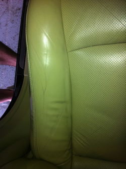

Took it in and after they complained about how bad this color was they finally agreed to replace it. Fast forward less than 4 months later and this is what the "FIXED" seat panel looks like. I am Not sure if you can tell from the picture but their replacement panel doesn't even match! Unfortunately, they are the only dealership in town so I am pretty much stuck for now. Just can't express how disappointed I have been with the dealership:tdown:. Love my FX but can't stand the dealership. Any suggestions?
i doubt you're gonna have much luck with the leather seats. your best bet would be to condition them thoroughly more often.

I have been conditioning them about monthly or so and I am not really having any issues with the original seats it is just that small panel they replaced. They used sub par materials. I agree with you I think that I am just pretty much out of luck.

I had my driver seat repaired for $400. The upholstery shop removed the leather, un-stitched the ripped seat panels (front and side) and replaced them with OEM panels before re-covering the seat. Looks perfect - as if I bought it new. Can't tell any difference at all.

I had Louetta Auto Upholstery repair/replace my cracking/torn vinyl sides (graphite) on both front seats for $195/per. Same day service, good as new....
I can honestly say, that is exactly what my gurlfriends 07 g looks like. I just think it is the leather and nothing can be done beside getting it redone with something of a different quality..
