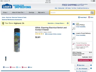

Thanks, guys. I've never heard of contact cleaner before. Stupid question but do I need to take the door apart to apply it or can I spray it in from the top of the switch with it still installed in the door?
Try it from the top of switch without disassembly first and see if that works.
Just make sure the cleaner you use is plastic freindly!
Please note that there are two types of these cleaner sprays, one leaves no residues after cleaning, and the other kind is what you need for your switch application because it lubricate as it cleans, which ultimately will protects against humidity, I agree that you need to be careful about that the product needs to be plastic friendly, otherwise you have to take it apart and spray it from the inside.
