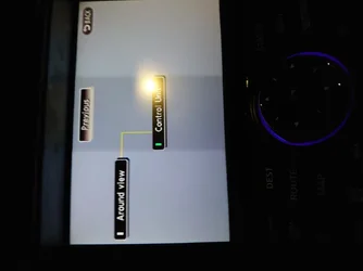

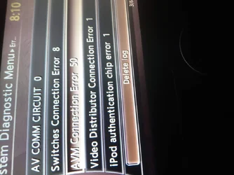

Hi, I bought a used qx70 2016 but the around view works only when I start the car for two minutes then doesn't turn on even if I press camera button or if I put it in reverse, and it only work for two minutes only if I start the car after its been off (idling)for hours, when I use the self diagnosis I get everything connected to the control unit in green line except the around view is in yellow line.
Tried disconnecting the rear and front camera but still not fixed, looked at the tailgate wiring everything is fine.DSC_0001.webpDSC_0013.webp
