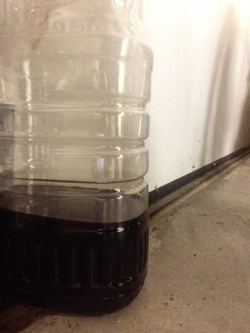

Here's swap #1. Pretty gross but not as bad as I was expecting:

Here's mine after 1.5 swaps. I thought it looked a little too red when I was taking it out for the second swap, so I thought a little more time to dilute would be good. It's hard to say though because it always looks red in small amounts, but then once it went into the bottle it turned that dark black. I don't think mine has ever been changed.
