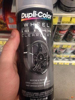

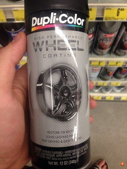

So, a couple cans of VHT, sandpaper, and clear coat cost a bunch less and some DIY feels nice.

See that looks awesome as well. I'm going to go back and talk to the shop because they're doing my body repair. Get the exact process of what they're going to do. May do the DIY.
If I do go the DIY, can someone recommend the exact products? That way if I go that route I can place my order.
I've always just had a shop spray it, tends to come out a bit cleaner than VHT since they're using spray guns and not cans. But if you really, really take your time, you can make VHT look good. I see too many VHT jobs that look uneven or runny or they didn't clear it so it looks matte. But jbaker's looks pretty good.
