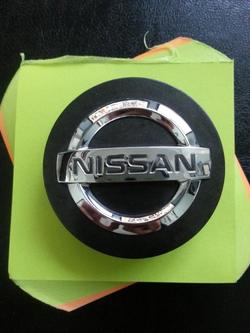

I got mine from the Infiniti dealer. I think they are around $30 each. No idea if they fit those wheels, but you could take the center caps to the dealer to compare. That's what I did, and when I took that pic.

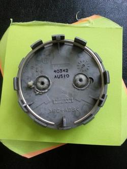

Just for anyone looking for Infiniti branded caps that fit the GTR wheels, they're 54mm overall diameter on the face and 51mm diameter from the outside of one tab to the opposite outside tab.
Nissan GTR Caps:
Infiniti Caps - Silver with Chrome logo (These are the same as the GTR caps above but with Infiniti logos instead, key is to look at this number on the back 40342-AU510):
