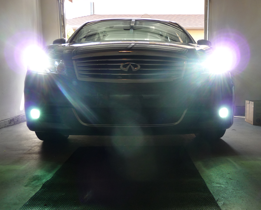

Car Model: 2007 Infiniti M35x
Low Beam: H1 6000k 55W Digital HID Kit from DDM Tuning
High Beam: 9005 Sylvania Xtravision Halogen Bulbs
Fog Light: H11 3000k 35W Digital HID Kit from DDM Tuning
Interior: No other work but planning full LED upgrade
Exterior: License plate lights and reverse lights converted to LED - rest coming soon
Other Information: I had issues with my low beam flickering and having issues starting. DDM replaced one of the ballasts and then I still had issues so they told me to buy a $35 harness that went from the battery to the OEM connections and then went to the bulbs. This fixed all of my issues and I've been fine since.
Pictures:
Low Beam Before:
Low Beam After:
High Beam Before:
High Beam After:
Rear of the car:
Other (55W 5000k Top Picture/55W 6000k Bottom Picture):
I will call this the "cheap mans" lighting upgrade mod. Everything purchased was from ebay, total spent for Low beams and Hid fogs was $55 with free shipping. I will probably regret being cheap later.

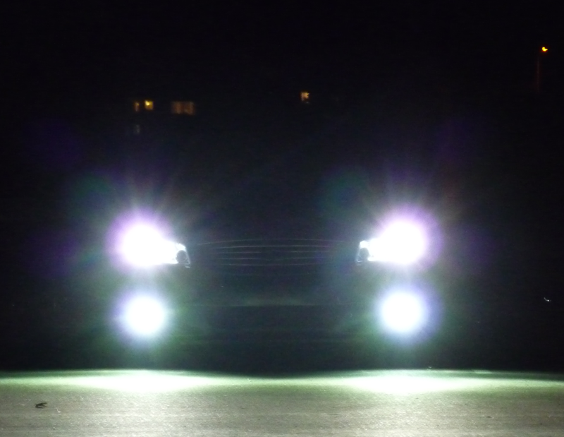

2008 Infiniti M45
Low Beam: D2S 6000K (ebay $12)
High Beam: Stock
Fog Light: H11 6000K Xentec Slim (ebay $33)
