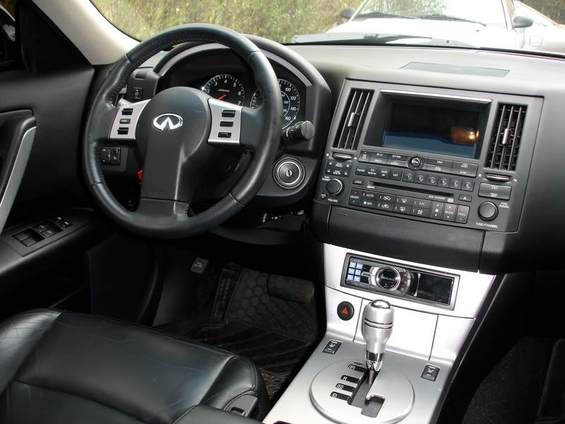

Aloha! I am looking into replacing my stock stereo unit for my 2005 FX35 for an aftermarket unit. Does anyone know of any that will fit in the stock unit without modifying the existing area where it sits. Let me know. Mahalo!

looked at the HK but wasn't a fan. this looks more OEM. especially with the led's color matched to the factory amber stuff. also looked into the tape player option, but it was a lot more work than this, you get into relocating the factory modules and all that, and its hard to go back to stock from a mod like that. this mod allows me to go back to stock in about 15 minutes. aftermarket HU's in the stock screen location are what i'd like to get to eventually. but again, that is a big mod, and its a LOT more expensive. this mod cost me like $150, and is 100 times better than the Nissan OEM iPod integration kit. got a full color screen with album art, and the functionality of the iPod. i was getting sick at the tough of browsing 40 gigs of music through one line of text, with only the track up/down, and fast forward and reverse buttons to navigate.

I liek the Hk because of where i mounted the controls and screen (under armrest;a-pillar, respectively). its extremely easy to go back to stock as well, without having to buy another piece of the console or the clock.
yea i just dont dig the aftermarket look of the HK i think was the biggest thing. sitting on the dash like that just screams "break my windows". I got a spare clock and trim piece on ebay for 8 bucks cuz it had a dent in it. i used that to fit the HU too, so when i go back to stock i'll be reinstalling the one that was in the car when i bought it.

Any double DIN aftermarket HU with 6.5" or 7" screen could be installed in the OEM location. You just have to relcate the amber info/AC/Radio screen somewhere, like the overhead sunglass holder.
