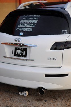

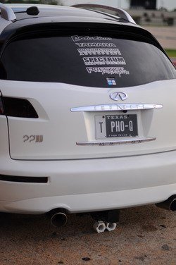

Car is looking bad but i wanted to show my new wheels.
My hood is black because i'm in the middle of peeling off the plasti dip to redo it. I'm still missing one mud flap but getting a replacement soon. I even photoshopped the mudflap on one of my pics LOL.
Hopefully i'll get all that fixed and new front bumper on soon.

Looks like you need some touch-up paint on your nuts. They are getting a beating.

Yeah that spray paint on my nutz isn't holding up too well. I need to stop dragging them on the ground LOL..
I'm thinking about powder coating them or chrome dipping the nutz and see how that holds up.
