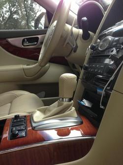

Hi Guy's, So I took the plunge and ordered a replacement knob for my beaten up 09 FX50S knob. I ordered this one. http://www.ebay.ca/itm/231004025438?ssPageName=STRK:MEWNX:IT&_trksid=p3984.m1439.l2649 Problem though, when I slip it down....the clip will not secure the shifter......it is because the shifter has not fallen down the shaft far enough........ I can see the clip recess on the shaft below the bottom of the shifter. How did you guys secure M45 Shifters ? Thanks !

Hi, Thank a lot. I figured that this would be the only way......but was thinking I would be etching into steel.....plastic...wooohooo :). Thanks for the pics, awesome. I will post up when done.

Stoopid Photo bucket inverted picture, sorry. Anyhow, thanks GEE35FX, this worked out awesome !!! Love it !!! Note to others, my 2009 FX50S had a metal shaft, so a hack saw blade worked perfect.

I just did this mod oh my 09 and it was a breeze. The shaft was metal so it did take a bit of sawing with a hacksaw to get the grooves deep enough. I basically put the new knob in place, ran the hacksaw back and forth in the grooves through the knob, then pulled it off and more sawing until they were deep enough. I found that at first the knob wouldn't stay in place (the retaining clips weren't seating) but I gave the kbob a good pop with the palm of my hand and they set it perfectly. Looks waaay better than the scratched up stock one.

Thanks for this thread and the pics. I just put an M45 knob on mine. My original knob was warn and scratched quite badly. the new one has the perferated leather and matches the perf on the seats and wheel like a champ. Took less than 5 min to install even with cutting the new grooves.
A simple and rewarding DIY.
