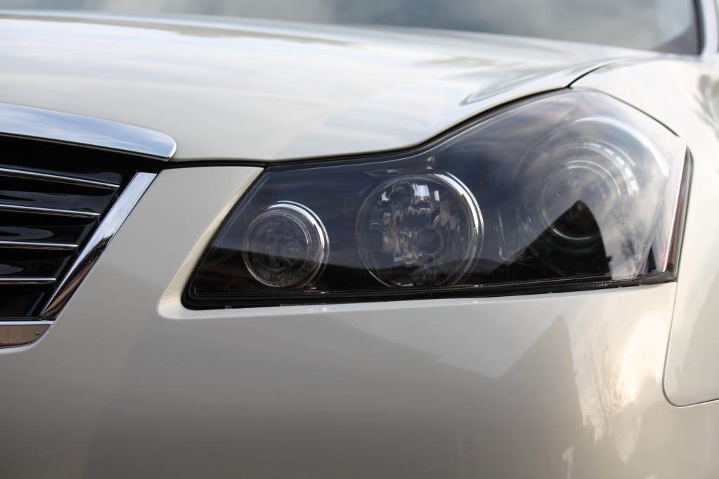

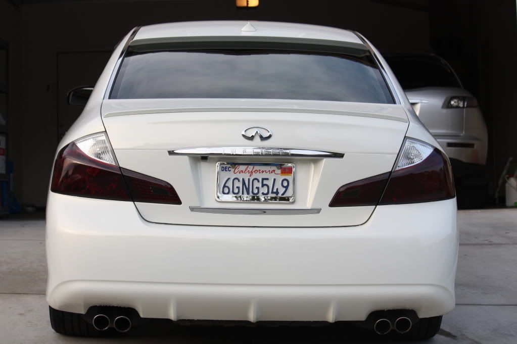

I just ordered Chrome 7440 for fronts and rears. I'll post before and after pix as soon as I get them in. I just wanted to get rid of the amber color in the housing.
I wish I can do a before and after, but you can compare them with your cars.
Fronts

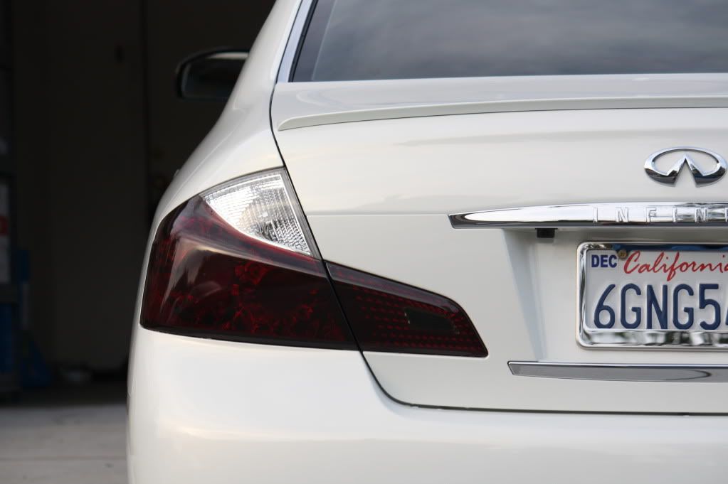

Rears

I followed your diagram. You have to remove the tail lights to install them in the back. They were pretty straight forward. I had to remove a portion of the air box to install driver side front. Fronts were a lot harder. I had scratches all over my hands plus, I had to remove a part of the air box to access the fronts.
All in all, I like the subtleness of them.
