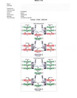

I finally got around to having the KYB shocks and struts installed today and also did an alignment at the same time. I recently had to replace both my front tires so this was the opportunity to get everything done at one shot. I will post a scan of my before and after alignment but my scanner is acting up on me so I will have that up at a later time.
Alignment:
Before / After:
Left Front
Camber (0.0 to -1.5) = -0.9 / -0.9
Caster (4.5 to 3.0) = 4.1 / 4.1
Toe (0.02 to 0.10) = -0.09 / 0.08
Right Front
Camber = -1.0 / -0.9
Caster = 4.2 / 4.2
Toe = -0.03 / 0.08
Front Total Toe (0.05 to 0.21) = -0.11 / 0.17
Steer Ahead (-0.05 to 0.05) = -0.03 / 0.00
Left Rear
Camber (-0.3 to -1.3) = -1.5 / -1.6
Toe (0.09 to 0.28) = 0.01 / 0.25
Right Rear
Camber = -1.8 / -1.9
Toe = 0.09 / 0.23
Rear Total Toe (0.19 to 0.55) = 0.10 / 0.48
Thrust Angle = -0.04 /0.01
I think I will invest in a rear camber kit to get it all in spec when I change out my 2 rear tires next summer.
Anyways, the feeling of the FX and ride quality much more solid and sturdy. That's the best description I can come up with but that's how I feel about the new install. Well worth the $217.88 I paid for this. Also, paid $180.00 locally for the installation and $70.00 for the alignment. Those figuers should give people a starting point as to the cost of this maintenance upgrade.
