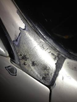

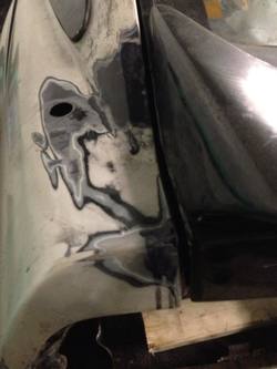

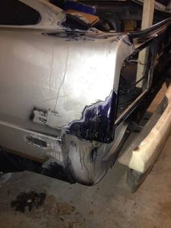

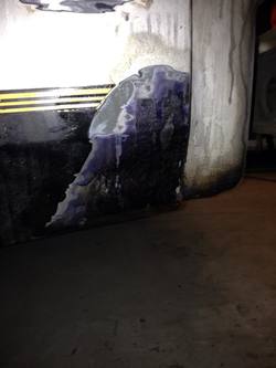

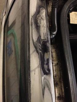

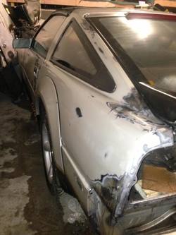

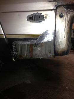

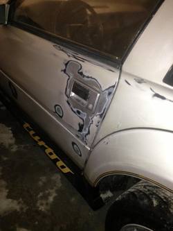

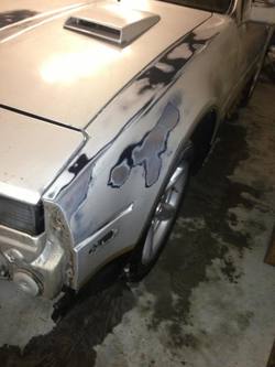

Was pretty busy Monday and today. The rust problems are 80% sorted out.
As shown in the pics below, I attacked all the spots with rust down to the bare metal, then
used a Rust spray (the purple/black looking stuff in the pics below) that forms a chemical bond to the rust in order to keep it form spreading. You can then sand it down and paint over it. For most of the spots, this is OK. For a few, however, there needs to be some filler/bondo added over this to get the body line straight, or in the case of the rear bottom 1/4, sheet metal welded in because the rust ate all the way through.
Since the motor is now coming next weekend instead of this weekend, I will try and have the entire car at least primed or maybe even painted (weather permitting) before dropping the motor in.
Before priming, I want to get the entire rear interior hatch area bedlined after repairing the interior rust, which I have also sprayed with the Rust spray but is much harder to work on down to the metal due to its location in the rear area.
I also want to get the seats figured out so when the motor does come in and we finally get it running, there's somewhere to sit ;)
As far as getting her running - Still need to get an EFI, but now I have another week and a half. Motor should now be coming on the 5th.
Enjoy some pictures of the carnage/progress:
spots needing filling:
dent in this section that will need bondo
I'm planning on deleting the antennae (that hole was the cause of most of the rust issues back here, anyway.)

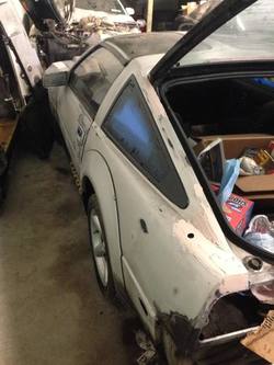

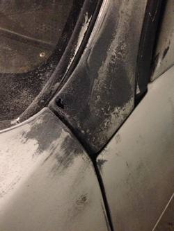

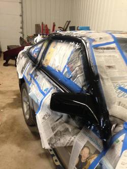

Spent a few hours today sanding the entire exterior of the car - trying to get it as smooth as possible. Got any un-poppable dents down to bare metal in order to apply bondo. Next week a friend of mine is plastidipping the entire car for free (I know, I know, it's plastidip. I'm holding off on a real paint job for now. plus its free) so I want to have the car primed and ready to receive a fresh coat.
Sanding
made a bit more work for myself since the p/o had painted the door handles, I used paint remover. A bit too much, since it screwed with the paint surrounding it. Nothing some serious sanding couldn't fix.
these areas are still a big concern. was thinking of just filling the gaps in and sanding/priming for now. (like this on both sides)

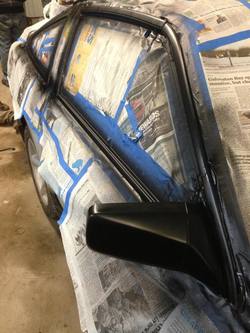

after sanding everything (including trim) I masked off and plastidipped the window trim/moldings and the side mirror
(ran out of 'good' tape when I got to other side - long story short it was too cold for cheaper painter's tape to work right and the 1 roll of 3m was the only one that would stick - heated the can of plastidip before using for the most even coat possible from a can - when my buddy sprays the car he'll use it from a gun with some thinner for an even coat)
Dry after about 4 coats. there were a few spots that were pulled because I waited too long to remove the tape. Will simply redo them later.

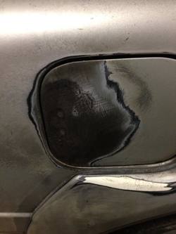

Then, I mixed some bondo and filled in the more serious dents around the car nice and thick to ensure even lines.
letting it cure overnight/for a day before touching it to make sure it's solid and ready for sanding.

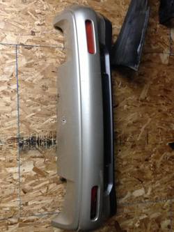

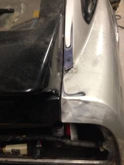

I removed the front bumper in order to pull the radiator and look for any hiding rust while I was sanding the car... can't wait for my motor to come in!
I got a 240 rear bumper from one of the guys I share the shop space with - the license plate recess should work perfectly for my plans to graft it into the oem bumper.
Yes, the bumper does not fit - I'm not using the entire bumper, however. Just the part where the license plate goes. Going to cut a hole in the oem bumper for it to fit in, and set up license plate lights for a nice OEM look. No license plates screwed into the bumper here. I want my Z clean.
Should be back at the shop in the next few days or so to finish up the body work and lay down some filler primer, sand, and prime again.

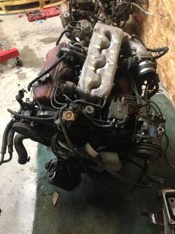

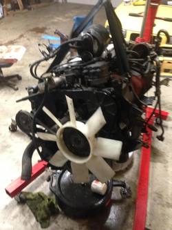

MOTOR!
A 1986 VG30ET with 92k original miles. No problems other than a leaky valve cover. With these motors, the problem areas are the exhaust manifold gaskets and the valve cover gaskets. On this motor, both needed to be replaced due to small leaks, however I would want to replace these anyway because I would like to clean up the valve covers (shine up that red color!) and have the exhaust manifolds “easy” to remove when needed.
The cool thing about this motor is that it’s from an AUTO zx, so it come with a clutch cooler and an oil cooler, both which didn’t come with the Manual cars. So, I’ll have the benefit of extra cooling parts without needing to go aftermarket. I just need to ditch the auto flywheel for a proper m/t one, and change the bushing/bearing.
The hairdryer
First thing I did was ditch the Air conditioning. I may regret it later with summer coming up, but the lines in the engine bay were cut anyway so that would be more money out of my pocket to get it working rather than just hooking it up again. Removing it makes the motor look cleaner anyway. (and shaves a few pounds…. Power/weight yo!) plus I have T-Tops!
Bolts and Nuts that have been sitting untouched for ~30 years (motor is an ’86, ar is an ’84) really need some “convincing” to be removed…and now I see why it’s sort of a given that you need to replace the studs on the exhaust manifold after you remove it for the “first” time…. All but 3 of them came right out. Luckily none broke, and the only bolts I stripped were ones that are easily replaceable.
Due to my inexperience and the lack of organization of my friends’ tools, it took me ~4 hours to remove a few things from the motor. This included spraying PB blaster + waiting, searching for the right extension, staring and trying to figure out what needs to get removed first in order for the thing behind it to be removed…
However, I’m glad I stripped it all down.
All the gaskets should be in by Friday, and I should have them replaced, new plugs in, new timing belt/tensioner and hopefully all other motor “stuff” finished by this weekend, including the harness wiring. Hopefully I can even attempt to drop the motor into the car by this weekend!

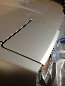

As for the car itself: ready for paint/dip
Going with an Aluminum/black two tone with silver metallizer gloss topcoat.
factory look with a little bling. Sort of like the GTR super Silver w/ black on the bottom.
Sprayed some aluminum on the headlight cover/fender to test it out. It should look great with about 4 more layers and some silver metallic flake.

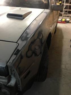

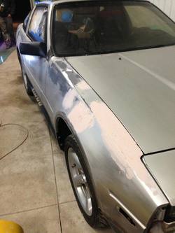

So, how the car sits while I’ve been wrenching away at the motor:
dat bondo
cut out the rusty section. There was much less rust through the metal than I cut, but at least the rear valence covers this area :-/

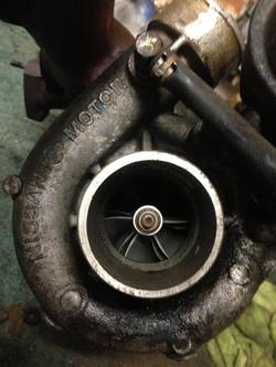

As far as plans for the car, popular upgrades are Holset HX35 turbos “relocated” to a top mount location for cooling / awesomeness. However, that’s another ~300 in piping (ss) then the downpipe needs to be altered, another ~$300. For now, I just want to get her running, so it may be best to use the factory turbo in the factory location and turn the boost up a bit with a manual boost controller. I have an intercooler for it (plus the oil cooler!) , so this should be good for ~9-13 safe psi now until I have the money to throw at aftermarket goodies. Plus the stock ECU map doesn’t really handle boosting over 13psi, - the car will run too lean. This should set me at approx. 275hp at the wheels with an open downpipe.
The goal now is to do maintenance, drop the motor in, and get it running. The car needs to be running for the aftermarket goodies to do anything, anyway.
So, this is where the project stands. Tearing down the motor, waiting for parts to arrive, but still trying to hurry this along to get it running very soon.

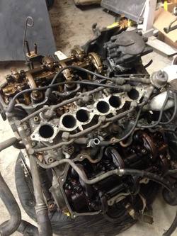

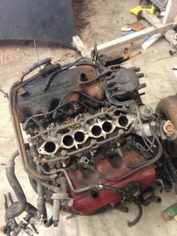

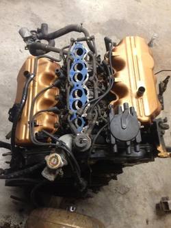

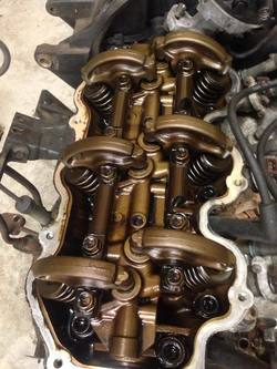

All the gaskets came in, so I took a day off studying for finals to try and get few of them out of the way.
Did the valve cover gaskets and got to the intake manifold gasket (also removed the exhaust manifold and have the gaskets ready)
Painted the valve covers in Gold to match the 50th AE gold trimming around the car, and did those gaskets. I think I may do the spark plugs before putting the intake manifold back on, plus I want to polish it up a bit more.
It seems like somebody has been in here to replace these gaskets before. One of the valve cover gaskets was very new, while one of the heads also seems to be newer than the other (although the EGR is on the 'dark' head so that may be the reasoning for it's color)
A lot of the bolts also seem to be new.
I'm happy about this - seems at least one of the previous owners was taking care of the engine.
Ran into some issues because one of the guys let our neighbor use the engine crane so I couldn't move it up to the engine stand to access the oil pan etc.
(changing those gaskets too)
It's also an issue to find the correct size bolts to mount the transmission to the motor, and the motor to the engine stand. The local places didn't have the right size.
Anyway, here's some pics.
Finals are coming up so I won't have a chance to work on the car until afterwards.
