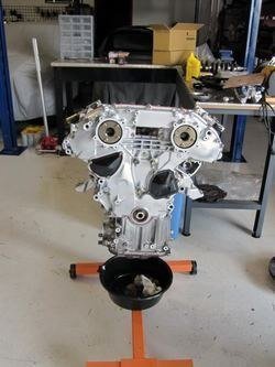

But I miss the car so much I had to go see her today. Bunch of parts back from being powdercoated, so the engine can finally be assembled. They tell me it should be back into the car by the end of the week.
It was pretty cool to see the timing cover open. It's not something I had seen on a VQ before:
In the upper oil pan, looking up from the bottom:

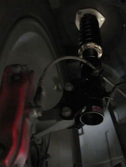

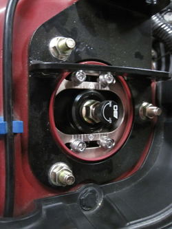

I also dropped off the BC coilovers. Since the fronts weren't attached yet, we saved a little wrench time on that install. As I left the shop, they were unboxing the suspension and said it should be bolted up by my next visit on Thursday.

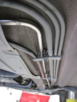

Shop visit was fun yesterday. Took some photos of the car up on the lift - I could see the new fuel system lines:
And the Fuel pressure reg to which they are routed:

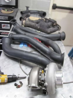

Here's the rest of the G35 kit we are butchering for my build (turbo is new and those are my OEM wrapped exhaust manifolds). Some of these parts will be cut and re-welded, then sent back out for ceramic coating.
Here's the Stillen exhaust cut off at the collector. Plan is to route the turbo outlet a full 3" downpipe all the way to this point:
