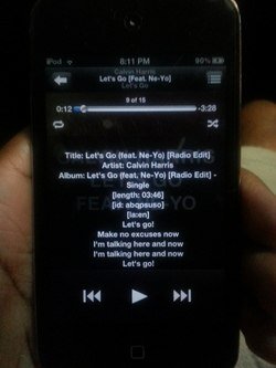

Alright, I just finished installing my iSimple Gateway for my FX.
It plays through my iPod well.
Anyway, there are two ports on the Gateway: Port 1 and Port 2 are for the iPod cable and the AUX cable.
But there's no way to cycle through the modes on the screen or steering wheel.
I read the manual thoroughly, but I don't know what I did wrong.
It doesn't even read what song is playing through the screen! :/

Nah, when I installed the MediaBridge it did the same thing. It's just the radio resetting after having the power removed. Do you have the latest firmware on the gateway? Otherwise, try the display button on the radio and see if cycling through that brings anything up.
Ooooo... I'm not sure.. fml lol and my iPod Touch is iOS 5.1.1, so it's probably ahead of my Gateway unit.
I'll contact the seller and ask him about the firmware version.
Also, I did try the display button and it just showed different displays of the word "AUXILARY 1" It's not even spelled correctly. :/

I installed mine on Sunday.
Mine had the same problem as yours, Auxiliary showing.
You have to read the manual and then select the source as iPod.
Once the source is as iPod then your FX will display the information on the Ipod.
I chose to NOT have the info displayed and kept is as Aux so that I can USE my iphone instead of being forced to go through the car knobs.
