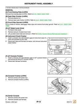

removing the metal panels on the wheel, and the center piece with the watch... please help, if anyone ash the instructions or maybe a manual with step by step pictures i would really appreciate it.
thank you in advance.
