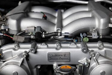

The INFINITI QX80 R-Spec build features a GT-R sourced 3.8-liter twin-turbo V6 that has received extensive modifications to be capable of 1,000 horsepower, with custom turbochargers, intercoolers, exhaust manifolds and an upgraded fuel system. Selecting a GT-R engine as a donor for this build was a direct nod to the lineage of the standard twin-turbo V6 in QX80, which is directly related to and incorporates numerous engineering innovations from GT-R.

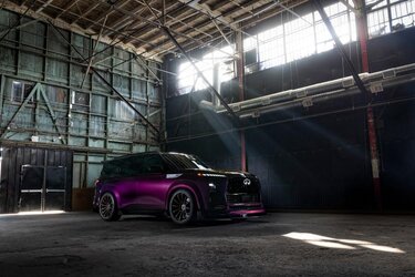

Matching its upgraded capabilities, QX80 R-Spec wears a custom body kit that is wider, lower and aerodynamically enhanced. All of its visual enhancements are directly inspired by the GT-R T-Spec Takumi Edition, starting with an incredible, color-shifting wrap that pays homage to the Midnight Purple colors made famous on the R34 and R35 GT-R generations. The R-Spec also has restyled exhaust finishers, diffusers, fog lights, badges and other design cues similarly drawn from the T-Spec Takumi Edition, making the connection to GT-R even clearer. This aggressive new appearance exaggerates the already powerful design of the INFINITI QX80 and clearly connotes its exhilarating level of performance.

  • Nissan GT-R R35 VR38 engine
  • JE Pistons, Boostline Rods, ARP rod bolts
  • MOTEC engine management
  • ETS exhaust manifolds with Garrett G-series turbochargers
  • Custom flex-fuel system with 2600-cc injectors and Fuel Lab fuel pump
  • Custom intake with twin front-mount intercoolers
  • Custom R35-inspired exhausts
  • Custom CNC transmission adapter
  • E-Locker rear differential
  • CSF engine and transmission coolers

Exterior​
  • Custom wide-body kit with functional aerodynamics
  • Custom ARP front splitter
  • Midnight Purple wrap
