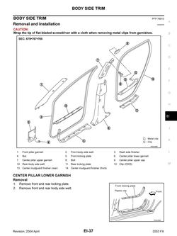

If I can remember correctly, it is held down by clips. Just wriggle it with downward and away from the pillar motion. Yes there is room for wire, but be careful placing the wire out the airbag's way. If you just going to run some wire along it, you can tuck the wire in without removing it.
My bad, there is no airbag on the A pillar. It was the airbag wiring and safety/hold down nylon strap. Here is a pic from Andrew's (AeroBFA) suede headliner make over. Not a very good pic.
---------- Post added at 09:48 PM ---------- Previous post was at 09:41 PM ----------
Confirmed. There are two metal clip. Just pull downward and away from the pillar from the upper portion.
