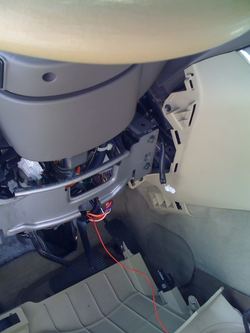

7) To access the wiring harness on the steering column, open up the steering column cover.
8) There is a white harness that leads to the starter. I only needed the accessory wire so the white wire is what I need to tap my DVD positive power source to. After the power tap, I installed a fuse linkage onto the line and run the wire behind the steering column cover and up through the driver side pillar. Not shown here but at the top of the pillar the side impact airbag starts. Instead of running the wire along this airbag, I crossed it over to the opening of the sun roof area and ran the wire close to the roof opening to avoid having any interference with the proper operation of the airbag.

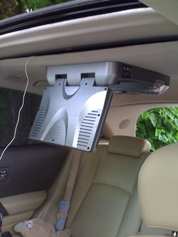

9) I ran the tapped accessory power wire between the headliner and the roof (shown in thick black here). Then I bolted the drilled bracket right onto the factory bracket (notice the silver bolts on the left side of the opening in the headliner. After the bracket is secured, instead of cutting up additional headliner to the size of my DVD bracket, I simply poke holes to line up with the the screw holes for the DVD to attach to its bracket (six holes were made for this).
10) With the bracket and power source in place and connected, I tucked all the wiring into the DVD cavity and secure the DVD onto it's bracket. I also ran the DVD FM modulator wire along the edge of the sunroof to maximize signal transmission to the radio.

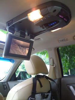

12) Once the DVD bolts are tightened firmly onto the bracket it actually help secured the headliner in place allowing the headliner velcros to attach firmly in place. And here are some pixs of the finished install:
Note the infrared signal captured by the camera. These infrared are for the two headphones included in the DVD kit.
