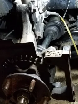

7) Remove the two 22 mm bolts to separates the knuckle from the strut assembly.

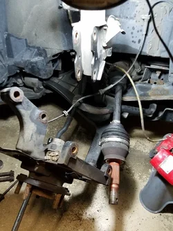

8) Separate the knuckle from the strut assembly. Be sure to use wood block to support the knuckle assembly. You may also want to remove the brake caliper and rotor for easier to get at the drive shaft.
9) Slide the outer end drive shaft off the hub.

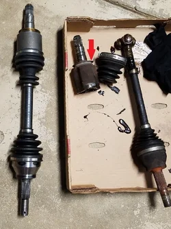

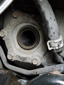

10) Use a pry bar at the inner end of the shaft to pry the shaft off the drive shaft off the front final drive assembly. It takes quite a bit of prying at different spot along the end plate. See the red arrow in the picture below where to stick the pry bar to.
11) Install the new drive shaft back in into the front final drive assembly carefully so that the spline on the shaft can mate up with the spline on the final drive assembly. Once you feel that it slide in smoothly, use rubber mallet to tab the outer end of the drive shaft to secure the drive shaft into the final drive assembly.
