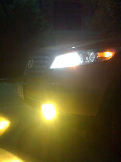

Oh, I just switched to 3,000K, MUCH better. No glare so far as I can tell in my garage. Time will tell when I can test it out better when it's dark outside.
I believe the blue ring is for 9005 bulbs and the orange ring is for 9006 bulbs. I had an extra 9006 bulb laying around and it has an orange o ring, similar in size to the extra o rings the DDM kit came with.
---------- Post added at 09:21 PM ---------- Previous post was at 03:07 PM ----------
Okay, drove around at night with the new setup:
OEM 7443 bulb instead of 6,000K LEDs
OEM Philips 4,300K instead of 6,000K Aftermarket D2S bulb
DDM 3,000K HID Fogs instead of 6,000K HID Fogs
Maybe I am getting old, but forget how cool 6,000K look from the outside, I'm sold on how bright and easy on the eyes 4,300K and 3,000K are!
That being said, after winter I'll probably changed back to 6,000K headlight/fogs :rofl:
Here is a picture with 6,000K D2S, 6,000K LED 7443 and 3,000K 9006 HID Fog Kit.
Both pictures are from my camera phone, so nothing great. The night picture is even worse and doesn't show how it "really" looks.
They are really yellow at night, this is just a shot during the day -- no Lamin-X (hasn't arrived yet):
This is a night shot of 4,300K D2S, OEM 7443 Bulb, and 3,000K 9006 Fog HID Kit:
