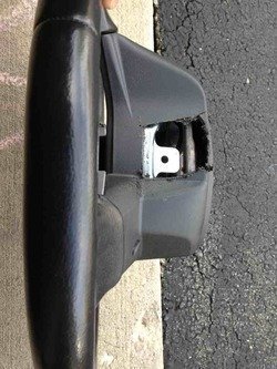

Chris what's the part number? Maybe someone here can buy it if they want to do the paddle shifters since it appears already butchered for it.

Here are pic of old steering wheel and the new one. Andrew had to work hard to get my old one off.
