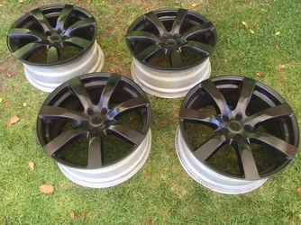

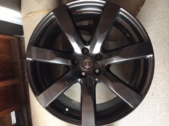

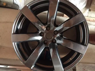

I just bought a square set of 2012 GTR Fronts (20 x 9.5s with a 45 offset) for my 2003 FX35 AWD which is lowered with H & R springs on KYBs...
Trying to find the right tire... I am changing over from a 22 x 9.5 wheel that I am running 285/40/22s and the 285s fits that rim perfectly, however the general consensus is to go with the stock size tire (265/50/20) which all the tire sites that I have looked at say is the optimum tire for a 9.5" wide rim. it just seems weird that the 265 tire (which is the stock tire size for the 8" wide stock wheel) will also fit a 9.5" wide wheel. If it does the wheel/tire should have the same diameter as the stock wheel tire configuration (so my speedo is accurate)...
I kind of like the tucked look... so, I will see how they look and buy spacers if needed...

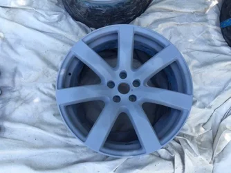

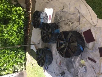

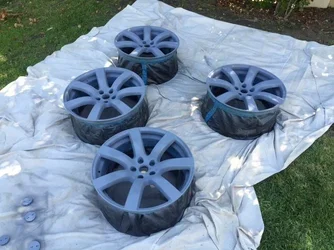

BTW - I picked up the set for only $620!!! They did have some minor scrapes so I am going to paint them black with Duplicolor...
Thoughts?
