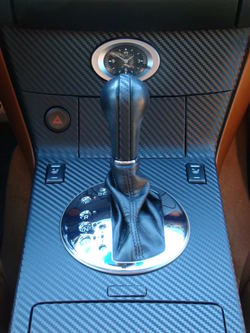

It took me roughly 3.5 hours between 2 days. Once you get the hang of it, you just keep going. Having the heat gun is what makes this an easy DIY. The hardest part is probably the most tedious part, cutting out the holes for buttons. Just dont be scared, worse come to worse, you can always take it off. The Vinyl is forgiving, so u can peel it off and reapply to reposition and stretch it a little.
I did my steering wheel controls in the car, I didn't want to take off the steering wheel. Heat gun and a hobby knife are the main tools you need.
Joe, it's cake for you if you decided to do it. Here a few pic of mine done about 11 months ago. Just thought they might helps in your decision. :wink:

i got 5 sq feet. it was $22 plus an extra 3 or 5 for shipping (depending how impatient you are!) that was just for the handles and the two center pieces. IF you also want to do the vents and around the GPS i don't know how much you need? I have some left so I can attempt to get the steering wheel done and some other odds and ends.

quick question on this ! did you use a large piece then cut to fit on the two center pieces ? or did you use two smaller pieces and lined up the CF lines. personally what scares me is not the wrap itself but lining everything up correctly I'd personally freak if the lines were not aligned, lol
You will have to use multiple pieces and try to line them up as you go. They're very easy to feel and adjust. Believe me, this stuff is very easy to work with and very giving. Anyhow, the cutout/left over say from the shifter panel will not be large enough to be use on the cup holder cover since you will have leave some slack to wrap the around and underneath corners and edges.

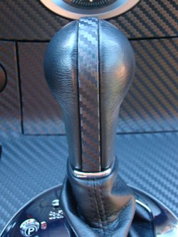

No, you have to cut it out and glue it back. Here a couple of pic of the trim on the shift knob.

I actually did not remove the piece off I actually just wrapped it while on the shifter. Then proceeded to just apply pressure then I just used my finger nail on the edges of the piece that you removed then proceeded to use a knife to remove the excess pieces.
