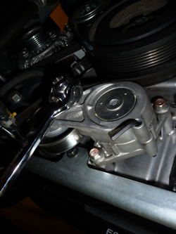

3. USE A 14MM WRENCH TO TURN THE PULLEY NUT ON THE TOP AUTOMATIC TENSIONER COUNTER-CLOCKWISE. (DO NOT TURN CLOCKWISE, IF YOU TURN CLOCKWISE YOU WILL LOOSEN THE PULLEY AND THE WHOLE AUTO TENSIONER ASSEMBLY WILL NEED TO BE REPLACED.) AS YOU TURN COUNTER-CLOCKWISE LINE UP THE HOLDING BOSS (TWO HOLES) AND INSERT A 6MM ALLEN WRENCH TO LOCK THE TENSIONER.

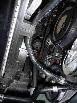

4. REMOVE THE A/C, WATER PUMP, ALTERNATOR BELT .

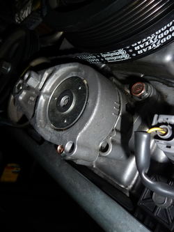

5. ON THE BOTTOM TENSIONER YOU WILL USE THE HEXAGONAL PROTRUSION PART WITH YOUR SOCKET TO TURN COUNTER-CLOCKWISE. AFTER LINING UP THE HOLDING BOSS INSERT YOUR OTHER ALLEN WRENCH.
6. REMOVE THE POWER STEERING BELT.

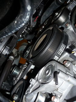

7. INSTALL YOUR NEW BELT, MAKING SURE ALL RIBS AND GROOVES ARE ALIGNED.
8. USING YOUR WRENCH ON THE HEXAGONAL PROTRUSION TURN IT SLIGHTLY COUNTER-CLOCKWISE AND REMOVE THE ALLEN WRENCH WE USED TO LOCK THE TENSIONER IN PLACE.
9. BACK ON TOP WE ARE GOING TO INSTALL THE NEW A/C, WATER PUMP, AND ALTERNATOR BELT. INSTALL THE BELT MAKING SURE YOU GET ALL GROOVES, AND RIBS ALIGNED. I INSTALLED THE BELT AROUND EVERY PULLEY AND TENSIONER AND SLIGHTLY LEFT IT OFF THE TOP WATER PUMP PULLEY.
10. USING YOUR 14MM WRENCH TURN THE PULLEY COUNTER-CLOCK WISE AND PUSH THE BELT ONTO THE WATER PUMP PULLEY. WHEN THE BELT IS LINED UP PROPERLY YOU CAN REMOVE THE ALLEN WRENCH THAT IS USED FOR LOCKING THE TENSIONER.
