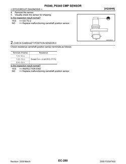

Can they give you more details about what is blocked? Is something blocking your exhaust? A blockage should not require a new engine. Really, unless you actually damaged an internal component of your engine like the pistons/rods/valves/cylinders, you should not need a new engine. Anything that attaches to the engine can be replaced separately. This is very strange that you only throw a code for a cam sensor but you're having all these other problems.
