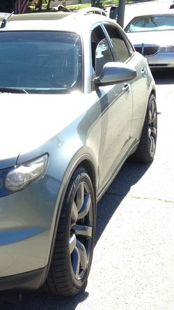

You will love these wheels. You can compare my specs to yours and see the flushness. I don't remember mine off hand, but I could use another 10 mm out in the rear to be perfect. Specs should be in this thread.

After a little searching I found your setup... 22x9 et30... Can you do me a huge favor and measure with a level from the outside of the fender to the edge of wheel? I wanna get as close as possible to being flush lol

just to put the "hellaflush" sticker on? lol it will be very flush and its probably not that noticable that its sunken if it is. itll be off by so little.
A 9" wide wheel has very little bearing on what you plan to get which is a 10.5" wheel. They don't even make the SDC in 9", it starts at 9.5" so a comparison to a 22x9" wheel isn't useful. Just use a wheel calculator, it doesn't matter what type/style/brand wheel you get, widths and offsets don't change because the style of the wheel does. You're much better off finding people with 20x10.5" wheels and looking at those pics vs. finding someone with a 22" version of the wheel you want in a width that isn't close to what you want. I'd recommend looking at the guys with GTR wheels, that will give you a much better idea of how a 10.5" wheel looks in back and what offset it takes to achieve it. A +30 in 10.5" will be sort of flush depending on tire size, but if you lower it, you'll likely need to trim the fender plastic. If you're not lowered, then it doesn't matter what offset you get, you'll never rub. Also, if you're not lowered, there's no point in being exact with the measurements, a few mm here or there doesn't impact the look or clearance when you have 3-4" of wheel gap.
