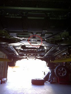

R ryus Member Location Canada Car 2010 FX35 AWD Oct 18, 2010 #1 For the 2nd gen owners who've jacked up the front before, is the part circled in red where to jack the front from?
jbaker1121 Im in touch with humanity iS VIP Location Westchester, New York Car 09 FX50 Oct 18, 2010 #2 I would just jack it from the side locations, I wouldnt use that to support the entire car
J Jmess86 Member Location Charlton, MA Oct 18, 2010 #3 Thats exactly where I jack mine up from, and if that fails I have a jack stand on each side (passenger & driver) of the frame rails.
R ryus Member Location Canada Car 2010 FX35 AWD Oct 18, 2010 #4 I got the official jack points page from the Service Manual for all 2nd gen owners to refer to. The red circled part is indeed the front lift point.
