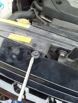

The first thing is removing 4 rivet fastener that on the top of the grill.

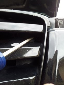

The remove 4 lock fastener with a flat head screwdriver keep in mind just 1/2 a turn with the screwdriver the fastener are located one at each corner of the grill.
Installation is the reversal of the removal processes. This is what the end look like. Tell me what you think.
