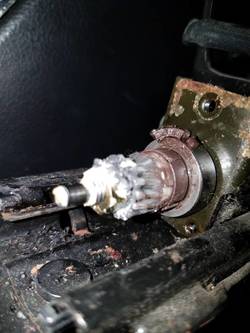

    Are you talking about this gear that need to be replace for the seat to move forward and backwards? 6bc1cc4ce7ce4f8505c07ba376ee93cb.jpg 4e4e75bf35cf6873f5f12c5dc7bd8ccd.jpg

    Sorry no, this would be the actual switch as depicted in the brown pics above.... mine would be the same but in black.
