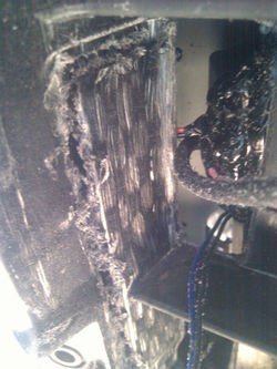

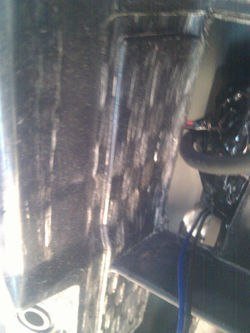

Bring out your dremel/rotozip/plastic saw and start cutting (remember the safety glasses, wear them now) - Follow the lines as much as you can and you should end up with this:

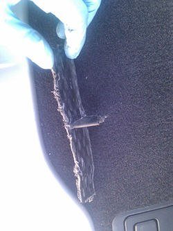

You will get a bunch of plastic dust everywhere, but nothing that can't be vacuumed out. Make a final cut flat with the opening, so that the trim piece you are removing is like a small T shape - You can now remove that entire piece out:
Look at all the room you have now created to get your hands/tools through and the essential camera module out!

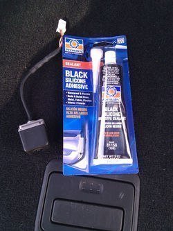

This is what I got for sealant:
Also today was actually pretty cold, making everything sticky pretty much 'frozen' - In order to get the sealant off easier, you simply heat it up :) A regular hairdryer works, but a heat gun is best:
Don't get it too hot, as you will burn your fingers.
