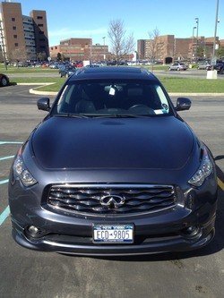

go from this:

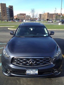

to this:

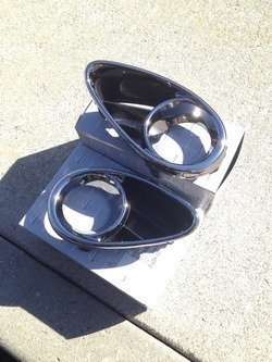

Step 1:
Open up and admire your new chrome pieces

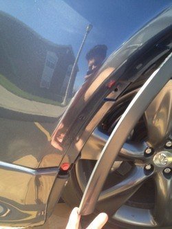

PRY OFF PLASTIC MOLDING PIECES
if you have the trim removal tools, now isa good time to use them. I didn't use them - it just makes it easier with them.
I like to push off the painted part with my thumb and hold the plastic with my other fingers - there are CLIPS holding the trim on so pull near the clips so you do not bend the plastic out of shape.
(that red clip came off of my trim -- yours will probably come off with the trim. Either way you can pop it out and slide it back on the trim.

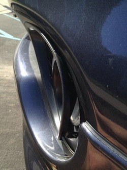

MOVE LOWER PART OF THE FENDER LINER OUT OF THE WAY -- IT IS FLEXIBLE SO DOES NOT NEED TO BE COMPLETELY REMOVED - YOU JUST NEED TO SQUEEZE ONE ARM IN THERE.
STEP 6:
Reach an arm in there -- easier to put your right in and position your body at the front left corner of vehicle..
There are clips on the top, bottom, and side of the trim parts -- feel around in there and you will feel them.
Push down the clips around the fog light - the top corner one just needs to be moved towards the foglight to unclip
slowly pull on piece with your left hand while unclipping wiht your right in there. I have longish arms so was able to do this. if you can't reach, I'm not sure what to tell you - you may have to take more pieces of trim off to reach, or do this on a lift.

Take your new chrome piece, and simply clip it into place - wiggle it a bit afterwards to ensure all of the clips have engaged.
