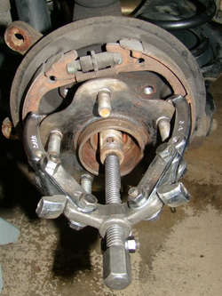

  8. Take the axle nut off half shaft. Using a rubber mallet to whack the end of the half shaft a couple of times to break it loose from the hub. If it is seized onto the hub, using a three-jaw puller to push the half shaft loose.DSC07149.jpg
